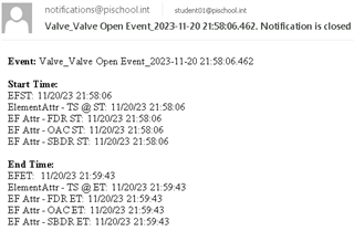

    Here is a message format:
    And here is a message generated by all of these:​
    As you can see, all of the methods generate equivalent results. I hope this was helpful. Please reply back if you have any questions.
