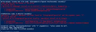

  • ​ Thanks for the script. I am trying to get FIltered Summaries for the PIPointList and needed the PIPagingConfiguration. I was getting this error in my script and when I ran your script as well. Not sure if its just a problem on my end.
    Even when I just run this command in powershell, i get the error.
    PS C:\Windows\system32> [OSIsoft.AF.PI.PIPagingConfiguration] $pagingConfig = New-Object OSIsoft.AF.PI.PIPagingConfiguration([OSIsoft.AF.PI.PIPageType]::TagCount,10)
    New-Object : Multiple ambiguous overloads found for "PIPagingConfiguration" and the argument count: "2".
    At line:1 char:55
    + [OSIsoft.AF.PI.PIPagingConfiguration] $pagingConfig = New-Object OSIsoft.AF.PI.P ...
      + CategoryInfo     : InvalidOperation: (:) [New-Object], MethodException
      + FullyQualifiedErrorId : ConstructorInvokedThrowException,Microsoft.PowerShell.Commands.NewObjectCommand
  • Just saw that my version of AFSDK is 2.9.1.8106 and it is supported.
