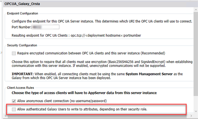

Can anyone confirm that de-selecting "Allow authenticated Galaxy Users to write to......" also will prevent anonymous connections to write when anonymous clients are allowed.? (SP 2023)

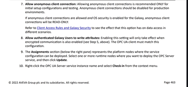

Hi, you can find information on this in the IDE user manual on page 463.
Thank you Kristian. I read this page again, and yes, you are of course right. Thank you!
