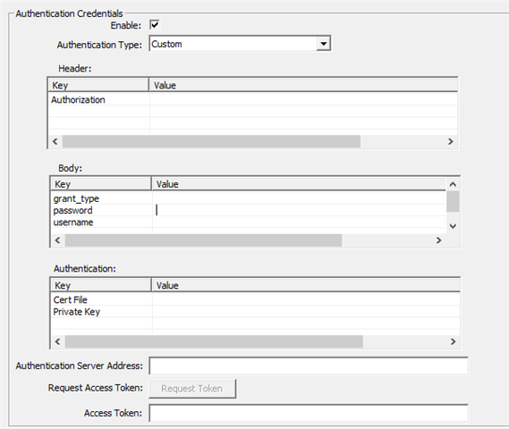

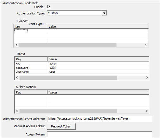

we have defined below contents in configuration:
Header
Authorization: (empty)
Body
username
password
pin
Authentication
Cert File: (empty)
Private Key: (empty)
we also tested with only body parameters by deleting all other parameters inside Header and Authorization.

I thought the reason why WEBSVC does not get token is similarly the SSL error...
My question:
How can I configure Custom Authentication with ignoring SSL certificate?
Or how can I configure Cert File field in authentication to make it recognize the certificate. I could not find any information in documentation to configure this.
On the other hand below is the logs for OI Server:
Instead of SSL, do I have misconfiguration for Authentication settings?
