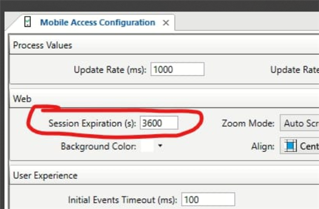

The default is 300 seconds (5 minutes) but If I change it to 3600 as you have shown in the screen capture, it stays at 3600.
Does the field revert back to 300 for you?
Does the field stay at 3600, but the session expires at 5 minutes?

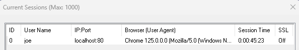

In both versions we tried, it worked as expected. Under and over 300 seconds worked. For example, I have this test set to 3600 and it has been running for 45 minutes:

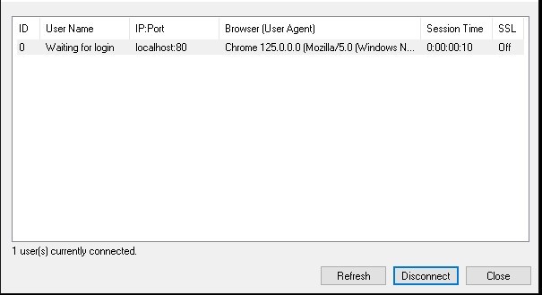

Hi Scott Kortier , what the function or program are you using to see the sessions ?

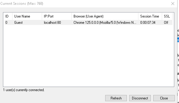

In the system tray there is an icon for "Mobile Access Task":
Scott

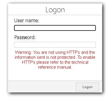

When the logon dialog appears in the browser, prompting the username and password to be entered again.

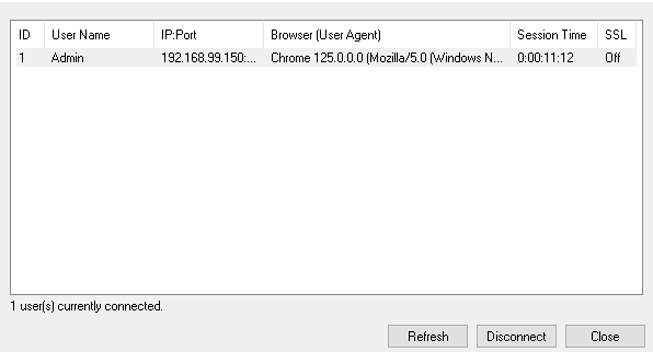

Below is what happens between 5 and 6 minutes after I login:

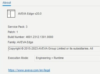

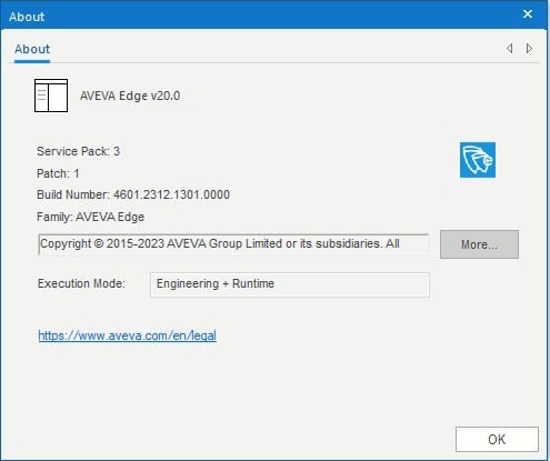

As for the version, it says Service Pack 3 in the about:

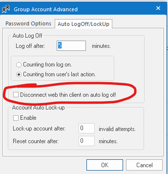

It looks like I found the solution in the Security System Configuration:
Even though I have the Log On after set to 0 minutes, the runtime still seems to pay attention to the "Disconnect web thin client on auto log off" check box and enforces the default 5 minute Session Timeout in Mobile Access.
However.... I just noticed the user changed from Admin to Guest after 6-7 minutes:
Perhaps the work around is if I set both the Log off after time and Session Timeout time both to 3600 and see the result.
I just saw my mistake! The Admin group has a auto log out time of 5 minutes.
