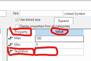

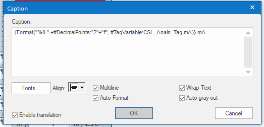

When creating Linked symbols, you can create "custom properties" the syntax is #PropertyName:optionalDefaultValue. The symbol itself won't consume any tags until you use the symbol and assign it tags. You can put a tag in as the Default value or assign it text in double quotes, or because it is optional, leave it blank (then it won't be assigned to a tag). For example when I define the symbol:
when I make it a linked symbol it shows this:
Notice the value is blank, but you can add a tag later.

If it is a standard (Bool, Integer, Real, String) tag it is true, you don't need to create a tag, and the "Custom property" is the place holder, the question will be how do you avoid creating a tag when you are using a Class?

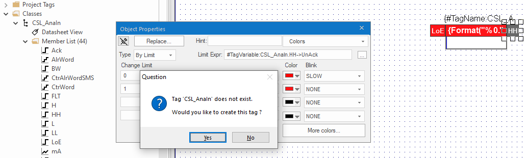

What he does is exactly what we are doing, the problem we found with that is that If we want to have the elements not related to a particular tag of project, we need to create a generic Tag, that we can move from one project o other, and tag is not connected to any PLC, but is wasting tag on my database, and if I have 10 classes on my library, and each class has 20 members, I am using 200 tags just for the Library, and that's what I want to avoid somehow.
This is what happens when you try to use the class name, it
I think I will have to pay the extra tags, with the engineering efficiency that we get back , by using this approach.
