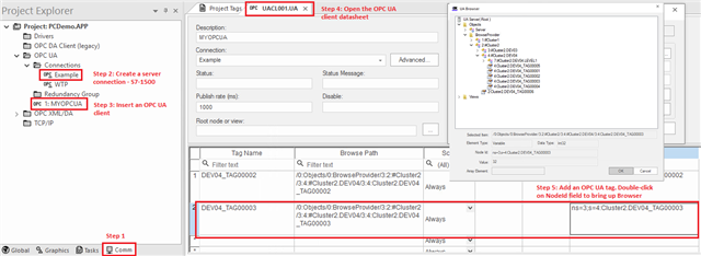

I'm working on a project trying to read the tags and data from S7-1500 from Aveva Edge OPC UA Client.
OPC UA Server is correctly configured in TIA Portal beacuse the UAExpert OPC UA Client works perfectly, but Aveva Edge doesn't show the tags to watch. It shows the PLC only with information in "DataBlockInstance" and "ServerInterface". However, that information is read as 0. The connection works fine as it is able to connect propperly. I have read that with S7-1200 it is needed to manually define the ServerInterface, so I have tried it for S7-1500, but it is still at the same point.
I'm sure I'm missing something in the configuration with Aveva as UAExpert OPC UA Client works fine.
