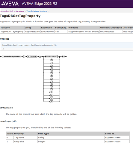

Dear Javier,
You can use the following function "TagsDBGetTagProperty"
Open help for a description on how to use this function.
Best regards.
You can use the Size property of the tag to get the array upper bound. If you had an array tag called arrTag, then you could get the upper bound of the tag array using this syntax,
$arrTag->Size
Note that the property is called Size, but it is not the array size. It is the upper bound of the array. All array tags in AVEVA Edge have a lower bound of 0.
