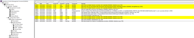

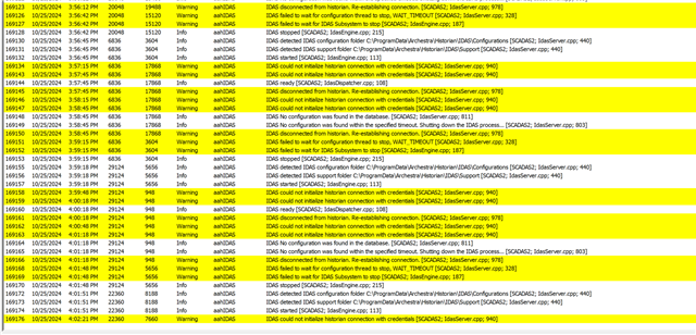

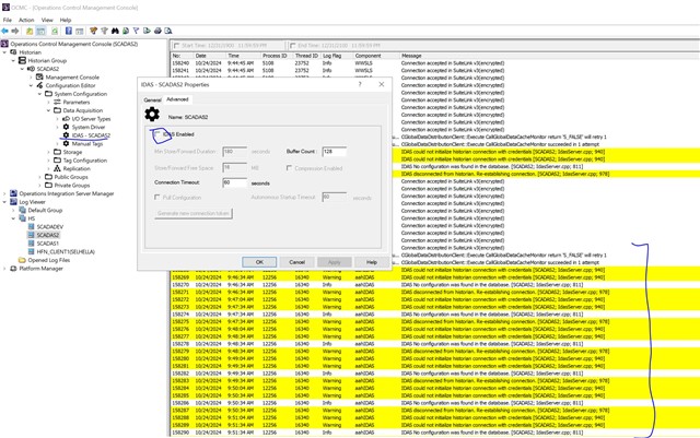

I just installed historian 23, and set it up as a partner retrieving data from Appserver only, It is running fine and syncing with the primary, but It continously gives me a warning trying to connect to IDAS . I have not activated any IDAS (see combined screenshot of log and IDAS properties window.) How do I completely deactivate this so I can get rid of the warning.??
and see if it will stop warning messages. Alternatively, remove its IDAS configuration in the following steps.
