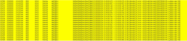

Occasionally, I see the following warning somtime in the Log Viewer:
GetNextDataQueryResult failed (17;2025/07/24: 21:45:00.677 --> 21:46:00.677; 2; SKU_Barcode_PC; error = 68 (Invalid item size)) [HISTORIAN-VM; o_pdsqry.cpp; 416]

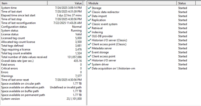

Additionally, I’ve noticed a delay in the availability of data. For example, at 14:00 today, the latest available data is only up to 23:59 of the previous day. After waiting 3–4 hours and running the same query again, the data finally appears up to the current time.
I’m worried that my implementation might be causing the delay or the warning, so any insight or suggestions would be really helpful.
