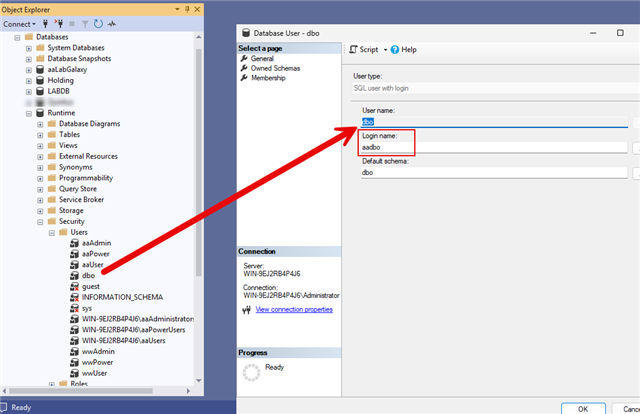

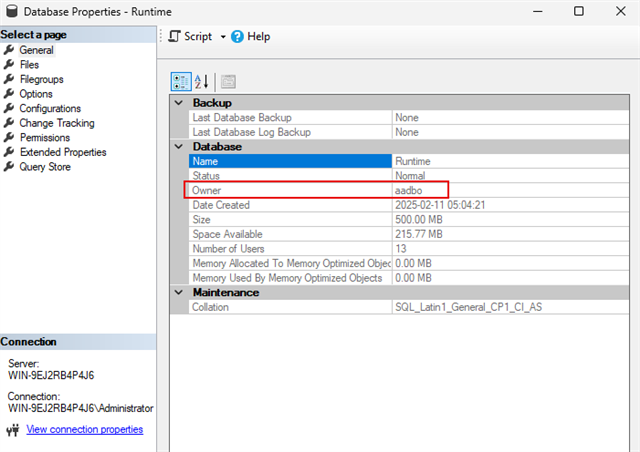

    ALTER AUTHORIZATION ON DATABASE::Runtime TO aadbo;
    aadbo (or dbo), is yet another user, (short for Data Base Owner)
    - ALTER AUTHORIZATION: This command modifies who owns a securable (in this case, a database).
    - DATABASE::Runtime: Specifies the database named Runtime as the target.
    - TO aadbo: Assigns ownership of the Runtime database to the principal (user or role) named aadbo.
    'dbo' in SQL Server:
    - It’s a default schema in SQL Server.
    - It represents the owner of the database, typically a user with full control over all objects within that database.
    - When you create a table or stored procedure without specifying a schema, it often gets assigned to the dbo schema.

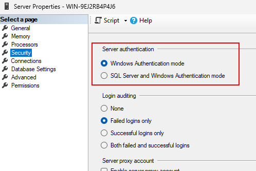

    A thing to note when moving up in versions of SQL Server, the SQL Server database users will be disabled by default and you have to enable them manually to get these users to work (if needed). it is of course advised to try and move to AD Users for access control, but if that is not your choice then they are there to be used.
    You then need to enable SQL Server as Authentication Mode in your SQL Server.

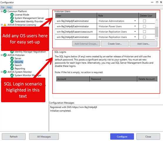

    So the script should be executed as described without any modifications, if you have manually created any additional users in your older version of the Historian then has to be taken care of manually.
    Preferably by running the security part of the configurator, after the migration.
