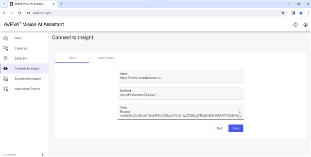

I am trying to configure Vision AI to post to Insight. The default is wonderware.com domain. How can I change to wonderware.eu?
This is not a hard coded selection. It can be self configured to point to the EU domain. Are you suggesting that this is not working correctly?

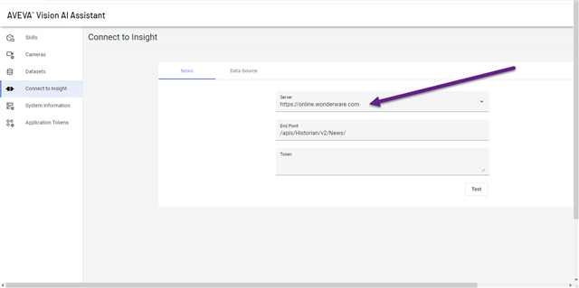

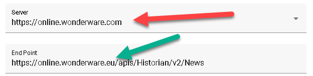

Following your comment I added the full End Point url including the .eu and the test succeeded. It is a bit confusing though that the Server url still shows .com.
And no, I can not change the Server url. It is a dropdown.
I am using ver 2.0.0.0
