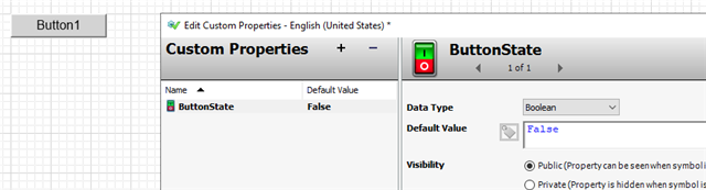

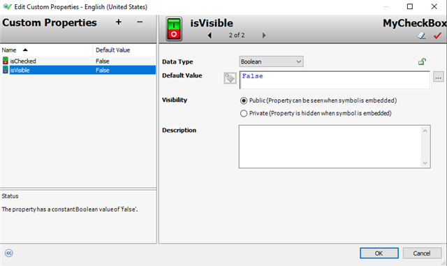

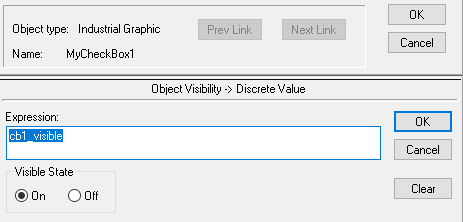

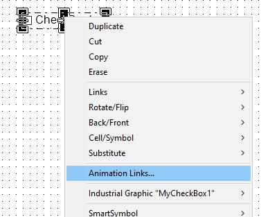

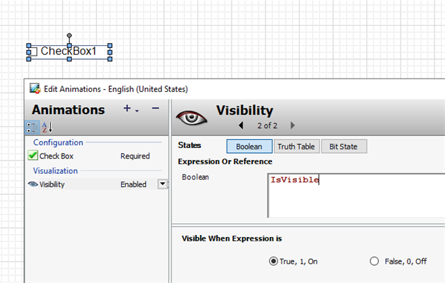

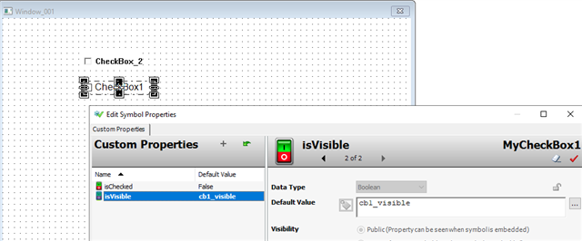

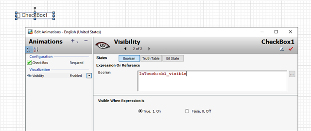

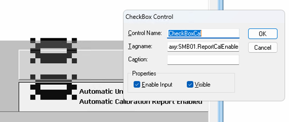

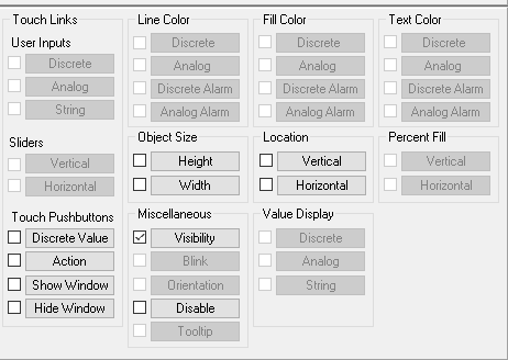

Just looking for a way to hide the CheckBox Control wizard used in InTocuh. In WindowMaker it has a check box for the Visible property but no way to animate it. Is there no way to change the setting outside of WindowMaker?
In WindowMaker there is a button with Visibility covering it and it is covering it on WIndowMaker but once you open the screen in WindowView the ChaeckBox is ontop of the button.
They are now on 2020 R2 but I guess the button used to cover them.
