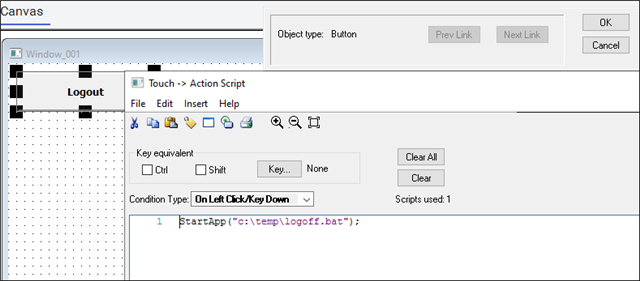

Executing a .bat file that logs out works, but not in the Shutdown script, it will not execute the StartApp() command needed when closing the program.
But you might work around it by creating your own close button.

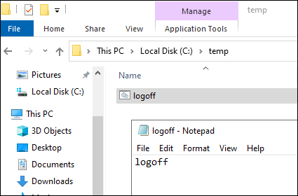

Create a .bat file with the command to logoff

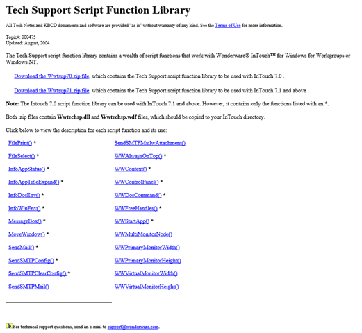

InTouch has a big bag of old tricks and one of them is some legacy Tech support script function library..
Keep in mind that I can not imagine these are supported any longer (well, I know for a fact that it is not...), but you have to decide if it is a suitable solution in your case.

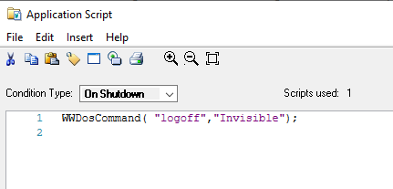

The script function library for InTouch 7.1 does have a function called WWDosCommand(), this will execute in the shut down script and log your session out.
You need to put the files in your InTouch installation directory (C:\Program Files (x86)\Wonderware\InTouch)
This will give you the above mentioned script functions and it works (at least in my test) using Version 2023 R2.
