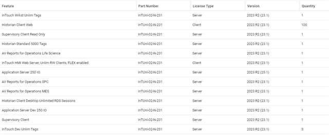

In our project we have Intouch Unlimited InTUnl-02-N-231 license.

How can I solve my issue in this project to run an Intouch application on the server and reach it from 7 different client computers with window viewer (not with web client) with my customer's license. Is it possible with the license we have?
