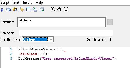

If the import fails to locate the tags it will modify the tag references, adding the prefix ?<datatype>:
