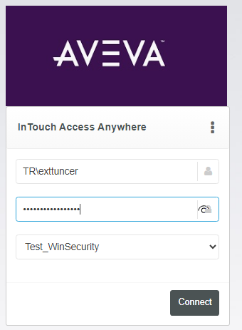

We can call Access anywhere from a client computer via browser with the address Servername:8080. The login page opens. We can put our username with domain (TR\extTuncer) and password. The projects in Intouch Server are already listed and we select the related project which is already running on server.

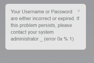

When we try to connect we get the fault "Your Username or Password are either incorrect or expired. If this problem persists, please contact your system administrator _ (error 0x % 1)"

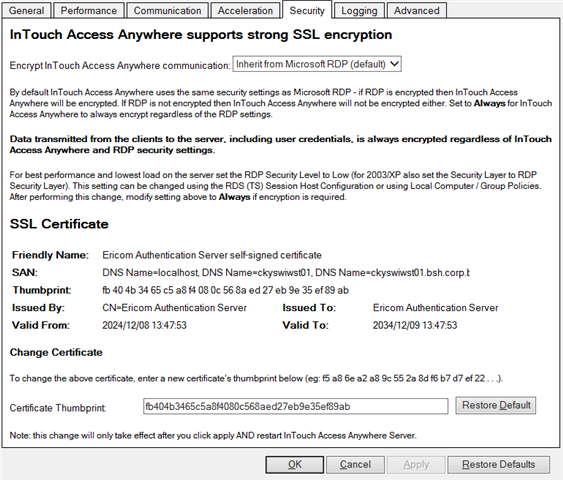

Below is the security setting of Access Anywhere:
In the document I saw that certificate thumbprint should be updated with the one installed. I copied the thumbprint and applied here.
I couldn't solve the issue and I am stuck.
