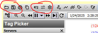

I am using the aaTrendControl to access data from our Historian and I need to disable \ restrict access to the file load, file save and server config icons, see below. Anyone done this before or know how to ?

I believe the only way to achieve this is to hide the enture toolbar (there's a property for this but I don't remember its name). I'm not sure if it is possible to hide or disable individual commands.
I second this, only the full top line tool bar can be hidden, individual commands cant be disabled
Hi Richard, thanks for the reply. I did have a look for such a property but couldn't find anything.
Do you know how to hide the toolbar ?

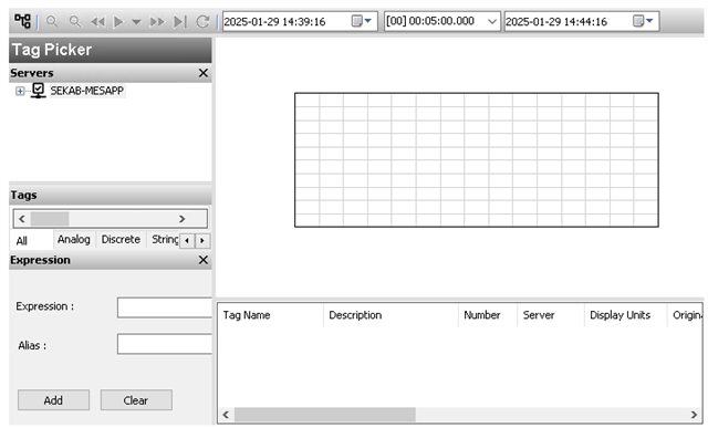

But this will Hide the Toolbar, you could set it in the OnShow script of the symbol, (and if needed you can have it appear based on logic).
Result:

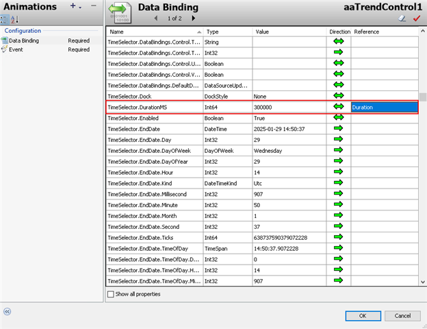

Example of a Property set in DataBinding, linked to a CustomPropery
