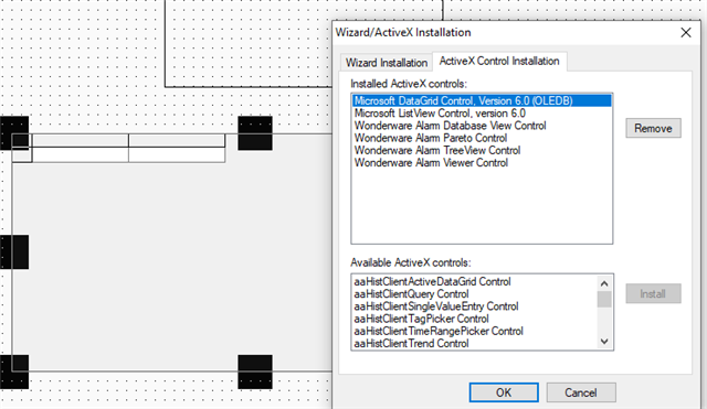

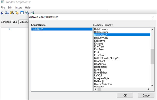

We have a traditional intouch project without industrial graphic tool, I want to use datagrid control to display SQL table data and do some simple searches.
I find it has the property of DataSource, how to fill this parameter?
Thank you.

Hi, to do this without Industrial Graphics will be a challenge since there is no built in SQL script library that can be used to link a dataset to the ActiveX Control's DataSource property. (requires data-type DataTable/DataSet)
Legacy InTouch uses SQL Access manager and bindlists to link rows of data from a dataset to InTouch tags.
This would work much easier if you would have possibility to use Industrial Graphics, I know you state that it is not available, but could be worth exploring?
In legacy InTouch where a datagrid was needed, we have created our own custom ActiveX that also manages the connection and query of data to a database, and not only the display the data, but I do not know if I would recommend that today since it is not the best solution for a future-proof solution, I would expect the support for ActiveX to be removed in future versions since it is a legacy technology that becomes harder and harder to maintain supported.

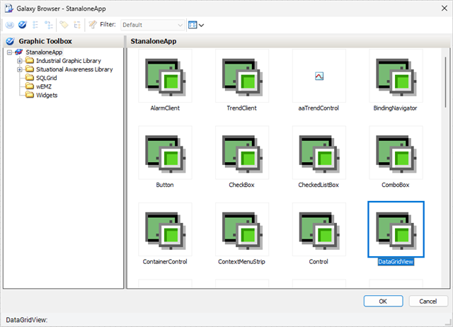

If you have Industrial Graphics available and want to use that microsoft control, you can import the .Net version of the grid, available from System.Windows.Forms.dll

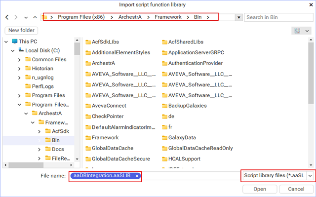

This, combined with the AVEVA aaDBIntegration script library should have you all set.
It is of course possible to use .Net scripting for the SQL Connection part, but the Aveva library has some advantages and can be executed Asynchronous.

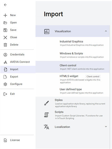

It is available by default in a Application Server solution but has to be imported in a stand alone InTouch application.
https://docs.aveva.com/bundle/sp-appserver/page/829001.html

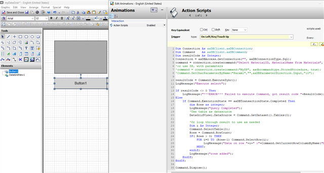

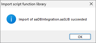

To import the Client Controls in your InTouch Application
Also import aaDBIntegration.aaSLIB, default location is
C:\Program Files (x86)\ArchestrA\Framework\Bin
Then you are all set to embed the DataGridView in a symbol
Then you can connect to your datasource and retrieve the data, loop through the result set or bind the datataset to your grid.
This example is quite rudimentary, it is advised to use Stored Procedures and Asynchronous methods to retrieve the data to avoid lock up of your application. But it should get you started.
Please reefer to the aaDBIntegration documentation for further information
Dim Connection As aaDBClient.aaDBConnection;
Dim Command As aaDBClient.aaDBCommand;
Dim resultCode As Integer;
Connection = aaDBAccess.GetConnection("", aaDBConnectionType.Sql);
command = connection.createcommand("Select MaterialID, MaterialName from Materials", aadbcommandtype.sqlstatement, true);
'or use SP, with parameters
'command = connection.createcommand("MySP", aadbcommandtype.StoredProcedure, true);
'Command.SetCharParameterByName("Param1","",aaDBParameterDirection.Input,"10");
resultCode = Command.ExecuteSync();
LogMessage("Execute select");
If resultCode <> 0 Then
LogMessage("***ERROR*** Failed to execute Command, got result code "+ResultCode);
Else
If Command.ExecutionState == aaDBTransactionState.Completed Then
dim Rows as integer;
LogMessage("Query Completed");
'Use table as datasource
DataGridView1.DataSource = Command.GetDataset().Tables(0);
'Or loop through result to use as needed
Dim i As Integer;
Command.SelectTable(0);
Rows = Command.RowCount;
IF( Rows > 0) THEN
FOR i=0 TO (Rows-1) Command.SelectRow(i);
LogMessage("Data on row "+i+" :"+Command.GetCurrentRowColumnByName("MaterialID"));
NEXT;
endif;
LogMessage("rows added");
EndIf;
EndIf;
Command.Dispose();
Connection.Dispose();

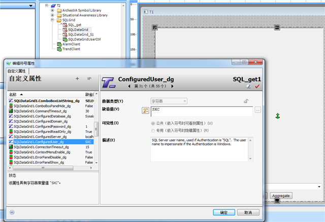

And I find a default SQLDataGrid tool to link and display the SQL data. It may not be as flexible in functionality, but it compensates with straightforward connections.
Thank you.
Indeed! Good thing that you mention this component as an alternative.
