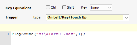

How can I implement the Playsound() function in InTouch Webclient to play audio files?

You need to make sure your script execution is within an Industrial Graphics Symbol for it to be available in the webclient.
It even works if the client is from a remote computer, (one would think the local reference could be a challenge).
edit! It will still play the sound on the machine hosting the application, not the client

Yes, our test is that the sound played is only on the server side, but how can it be made on the web client side? the web client and server are not one computer node
I do not believe it will work for InTouch Web, since scripts are executed on the server. We foresee shifting script execution to the client in the future, and as we do so we need to ensure that resources such as that wav file may be attached to the client-side payload.

BTW, I can confirm that PlaySound() is currently not supported by the web client. See Known limitations
My test environment is SP 2023 R2 SP1 P01 and VMWare.
I added a button with playsound() scripts in the application in VM, and it can work in web client from my host laptop.
Hi zhen shang and rickard.norin Playsound function is working on the web client but only web server side which maybe the reason why AVEVA says not supported.
Yes, I think Rainer has it right. I wouldn't expect it to work when accessing the web server remotely.
I think this audio file is only played on the server side. In your environment, the device that the sound device is only your host. Therefore, you may mistakenly think that the sound is emitted by the web client.
