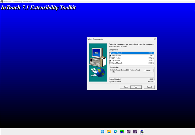

But I have a copy of the media "Classic Toolkits" from May 2009
This includes InTouch711 Extensibility Toolkit based on the Rev.A-July_2003 package.
Here the is the InTouch Database External Access (IDEA) Toolkit available for install.
Reach out to me if you want me to provide a copy of the installation media.
But if you can run it without the FS2K Components I don't know, and if you are on a 64 Bit OS there are some heads up in this technote.
