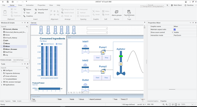

Hi experts,

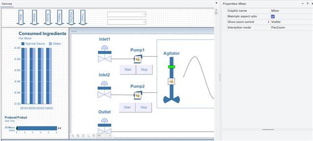

When I create a Frame Window and drag a symbol in it ,I can set  the property of interaction mode to PanZoom as below:
But I want to use showgraphic() function to show the symbol dynamically ,I can't find the property of interaction mode to set.

    The example comes from InTouch HMI standard training material.

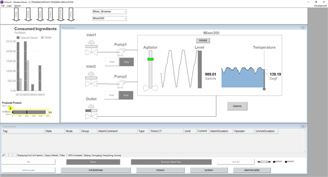

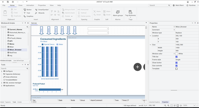

    There are two frame window, one is Mixer, and another one is Mixer_Brower.
    Mixer Frame window has embedded a industrial graphic named Mixer ,and I can set interaction mode to PanZoom.
    The Mixer_Browser Frame Window is empty ,
    and it can display different Mixer object dynamically in the runtime.
    What I want to is the Mixer_Browser has the function to Panzoom, but I don't know how to achieve it.

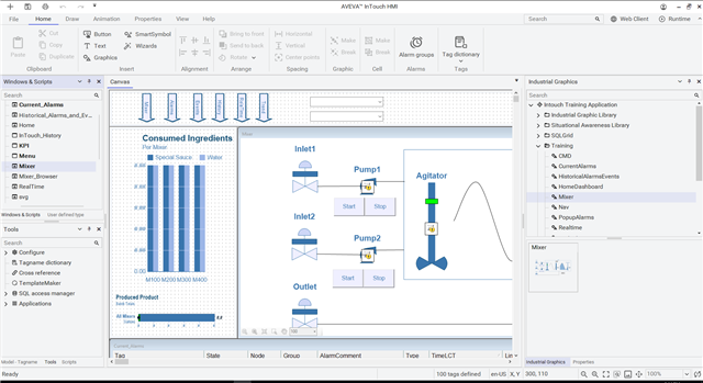

    Step1:Create a frame window and a industrial graphic;
    Step2: Embed the industrial graphic in the frame window and set the interaction mode property to PanZoom;
    Step3:Use showgraphic() to change the custom properties of the industrial graphic .

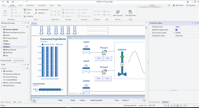

    Step1:
    There are a frame window named mixer and a industrial graphic named mixer. Embed the industrial graphic into the frame window;
    Step2:
    Set the interaction mode property to PanZoom;
    Step3:

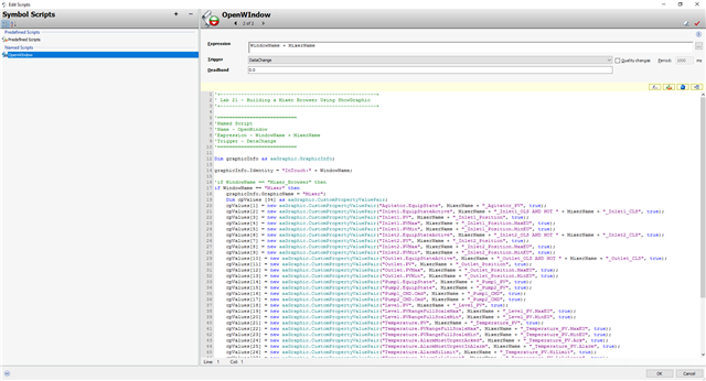

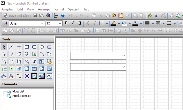

    Create a industrial graphic named Nav,
    step4:
    In the Nav symbol scripts pane ,add a named scripts:
    Dim graphicInfo as aaGraphic.GraphicInfo;
    graphicInfo.Identity = "InTouch:" + WindowName;
    'if WindowName == "Mixer_Browser" then
    if WindowName == "Mixer" then
    graphicInfo.GraphicName = "Mixer";
    Dim cpValues [34] as aaGraphic.CustomPropertyValuePair;
    cpValues[1] = new aaGraphic.CustomPropertyValuePair("Agitator.EquipState", MixerName + "_Agitator_PV", true);
    cpValues[2] = new aaGraphic.CustomPropertyValuePair("Inlet1.EquipStateActive", MixerName + "_Inlet1_OLS AND NOT " + MixerName + "_Inlet1_CLS", true);
    cpValues[3] = new aaGraphic.CustomPropertyValuePair("Inlet1.PV", MixerName + "_Inlet1_Position", true);
    cpValues[4] = new aaGraphic.CustomPropertyValuePair("Inlet1.PVMax", MixerName + "_Inlet1_Position.MaxEU", true);
    cpValues[5] = new aaGraphic.CustomPropertyValuePair("Inlet1.PVMin", MixerName + "_Inlet1_Position.MinEU", true);
    cpValues = new aaGraphic.CustomPropertyValuePair("Inlet2.EquipStateActive", MixerName + "_Inlet2_OLS AND NOT " + MixerName + "_Inlet2_CLS", true);
    cpValues[7] = new aaGraphic.CustomPropertyValuePair("Inlet2.PV", MixerName + "_Inlet2_Position", true);
    cpValues = new aaGraphic.CustomPropertyValuePair("Inlet2.PVMax", MixerName + "_Inlet2_Position.MaxEU", true);
    cpValues[9] = new aaGraphic.CustomPropertyValuePair("Inlet2.PVMin", MixerName + "_Inlet2_Position.MinEU", true);
    cpValues[10] = new aaGraphic.CustomPropertyValuePair("Outlet.EquipStateActive", MixerName + "_Outlet_OLS AND NOT " + MixerName + "_Outlet_CLS", true);
    cpValues[11] = new aaGraphic.CustomPropertyValuePair("Outlet.PV", MixerName + "_Outlet_Position", true);
    cpValues[12] = new aaGraphic.CustomPropertyValuePair("Outlet.PVMax", MixerName + "_Outlet_Position.MaxEU", true);
    cpValues[13] = new aaGraphic.CustomPropertyValuePair("Outlet.PVMin", MixerName + "_Outlet_Position.MinEU", true);
    cpValues[14] = new aaGraphic.CustomPropertyValuePair("Pump1.EquipState", MixerName + "_Pump1_PV", true);
    cpValues[15] = new aaGraphic.CustomPropertyValuePair("Pump2.EquipState", MixerName + "_Pump2_PV", true);
    cpValues[16] = new aaGraphic.CustomPropertyValuePair("Pump1_CMD.Cmd", MixerName + "_Pump1_CMD", true);
    cpValues[17] = new aaGraphic.CustomPropertyValuePair("Pump2_CMD.Cmd", MixerName + "_Pump2_CMD", true);
    cpValues[18] = new aaGraphic.CustomPropertyValuePair("Level.PV", MixerName + "_Level_PV", true);
    cpValues[19] = new aaGraphic.CustomPropertyValuePair("Level.PVRangeFullScaleMax", MixerName + "_Level_PV.MaxEU", true);
    cpValues[20] = new aaGraphic.CustomPropertyValuePair("Level.PVRangeFullScaleMin", MixerName + "_Level_PV.MinEU", true);
    cpValues[21] = new aaGraphic.CustomPropertyValuePair("Temperature.PV", MixerName + "_Temperature_PV", true);
    cpValues[22] = new aaGraphic.CustomPropertyValuePair("Temperature.PVRangeFullScaleMax", MixerName + "_Temperature_PV.MaxEU", true);
    cpValues[23] = new aaGraphic.CustomPropertyValuePair("Temperature.PVRangeFullScaleMin", MixerName + "_Temperature_PV.MinEU", true);
    cpValues[24] = new aaGraphic.CustomPropertyValuePair("Temperature.AlarmMostUrgentAcked", MixerName + "_Temperature_PV.Ack", true);
    cpValues[25] = new aaGraphic.CustomPropertyValuePair("Temperature.AlarmMostUrgentInAlarm", MixerName + "_Temperature_PV.Alarm", true);
    cpValues[26] = new aaGraphic.CustomPropertyValuePair("Temperature.AlarmHiLimit", MixerName + "_Temperature_PV.HiLimit", true);
    cpValues[27] = new aaGraphic.CustomPropertyValuePair("Temperature.AlarmLoLoLimit", MixerName + "_Temperature_PV.LoLoLimit", true);
    cpValues[28] = new aaGraphic.CustomPropertyValuePair("TempPen_PV", MixerName + "_Temperature_PV", true);
    cpValues[29] = new aaGraphic.CustomPropertyValuePair("TempPen_Min", MixerName + "_Temperature_PV.MinEU", true);
    cpValues[30] = new aaGraphic.CustomPropertyValuePair("TempPen_Max", MixerName + "_Temperature_PV.MaxEU", true);
    cpValues[31] = new aaGraphic.CustomPropertyValuePair("LevelPen_PV", MixerName + "_Level_PV", true);
    cpValues[32] = new aaGraphic.CustomPropertyValuePair("LevelPen_Min", MixerName + "_Level_PV.MinEU", true);
    cpValues[33] = new aaGraphic.CustomPropertyValuePair("LevelPen_Max", MixerName + "_Level_PV.MaxEU", true);
    cpValues[34] = new aaGraphic.CustomPropertyValuePair("Tank.Label", MixerName, true);
    graphicInfo.CustomProperties = cpValues;
    endif;
    ShowGraphic( graphicInfo );

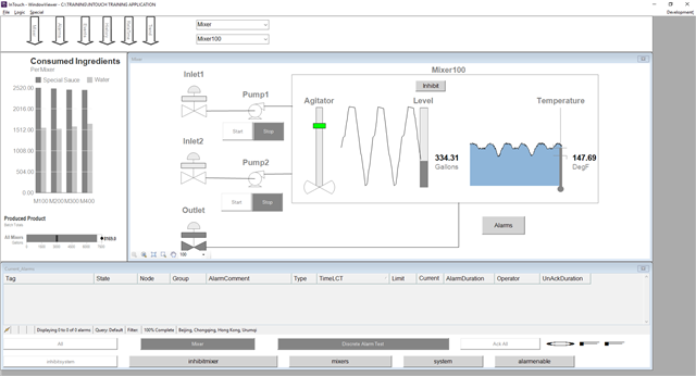

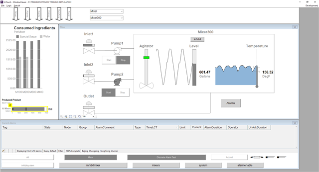

    step 5: demo run
    choose mixer100 asset
    choose mixer300 asset
    There is  a zoom setting in the bottom left of Mixer.
    Hope this information is useful for you.
