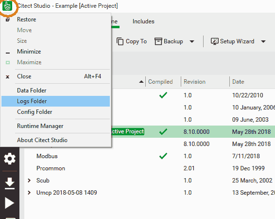

  • Hi,
    You are running Citect as a service, I doubt whether this is supported with demo mode.
    The service will have the Demo license and the display client tries to get a Control license.
    Check the help "Runtime > Running the System as a Windows Service | Runtime" and the note there.
    For demo I would suggest to stop or disable the "Citect Runtime Manager" from the Windows services.
