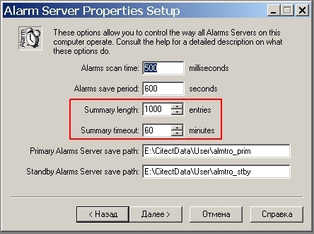

From the time I started work with Citect in 2010 I remember in Wizard was a parameter "Summary length" in rows (how much alarm can be in Summary? for example we set 10 000, 10 001 alarm will replace the oldest) but in production we want to save alarms in time period ( 3 months or 2 years).
By the reason we didn't use Summary

    What version of Citect SCADA are you using? In v7.30, a new alarm backend was implemented, which meant that the Alarm Summary feature was deprecated.
    In V7.50, the Alarm Summary feature was re-instated, but it doesn't use the [Alarm]SummaryTimeout or SummaryLength parameters anymore. These are controlled by new parameters, KeepOnlineFor and ArchiveAfter. Please consult the online help for details.

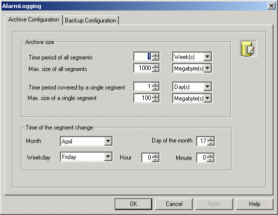

    For you best understanding we can see to WinCC - easy way to get what you want located in one place "alarm configuration" where you can choose all you need (see the picture below)

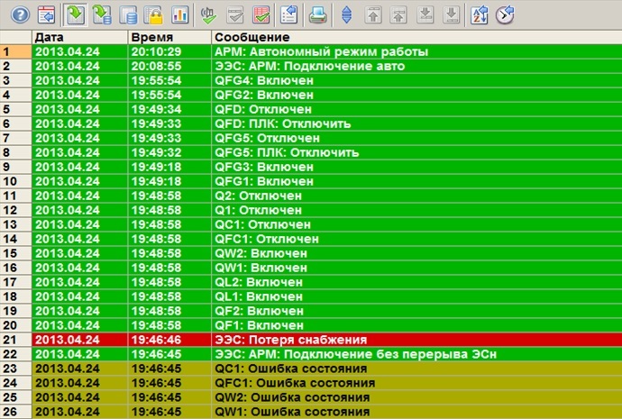

    The next question is how to display alarm log on a page. For trends in Citect we have good tool ProcessAnalyst instead of piling up misunderstandings in the form of element Trend and based on it pages where texts, buttons etc linked via Cicode. It look nice, work good (excluding trend export).
    If we look at WinCC by this question we can see nice a-la ActiveX element to display ALL type of alarms in table view with dynamically coloring rows? filtering, printing, sorting etc.
    Does Citect have anything like this tools ?

    The SOE page is capable of displaying all events in the alarm sub-system. By default it filters out some types, but you can create an alarm page based on the template and set it to display all alarms.
