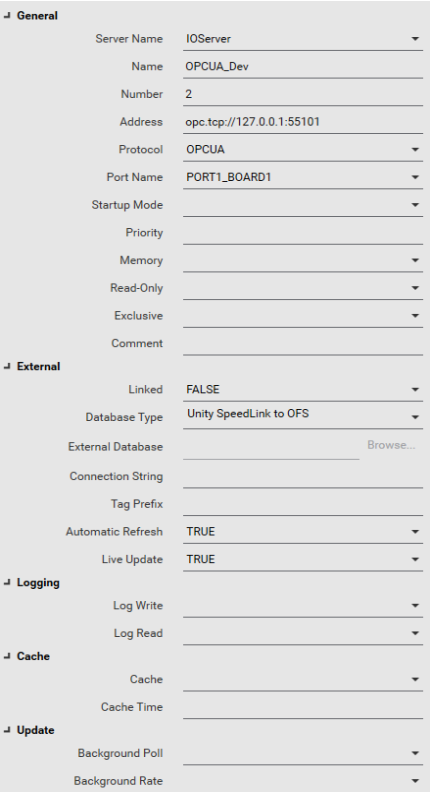

SCADA works in the following configuration:
PLC S7-300 => Simatic NET OPC-UA Server => Citect 2018(v 8.10)
I/O Device configuration:
 There is a button with not working code on the page:
OnUp      =>     TAGNAME = False;
OnDown  =>    TAGNAME = True;
Enabling Background Poll (Rate = 00:00:01) does not affect for this.
If I place any animation with TAGNAME on the page, the button begin working.
