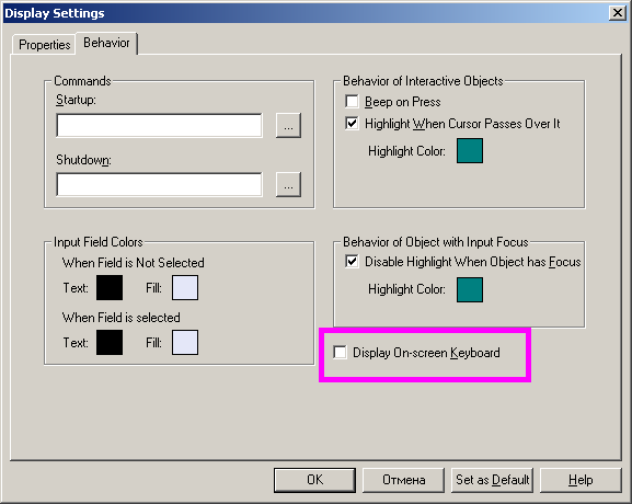

  • I think the simplest way to get OnScreen keyboard in SCADA is built-in feature like in RSView32 (one checkbox and in runtime it works like Android pop-up keyboard)
    A user don't care about keyboard on touchscreen in this case

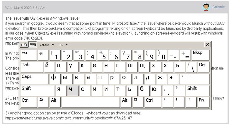

  • On Win7 with touchscreen we use built-in in Windows TabletPC keyboard

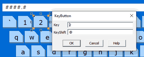

  • Note that I designed that Cicode Keyboard so you can easily customize it for your own language or special characters. Just open the !Keypad page and double-click a key button. The genie form allows you to enter the character for that key, and optionally an alternative character for Shift mode (or Shift mode just capitalizes the normal character).
    You can make more key buttons or delete them. I haven't tried it with non-English characters, but as far as I know it should work. You don't need to edit any Cicode.
