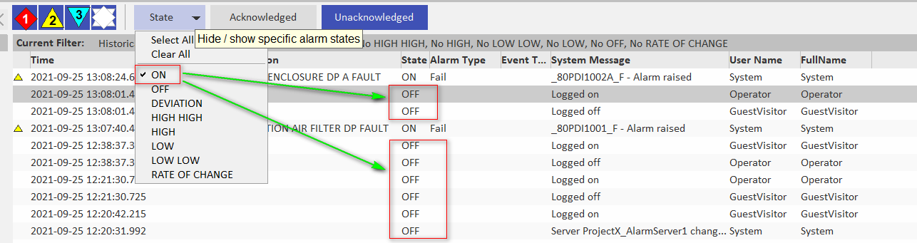

Please see my screen shot below, is there a way to hide/show the system events as indicated?
It seems like these events are not part of the filters.

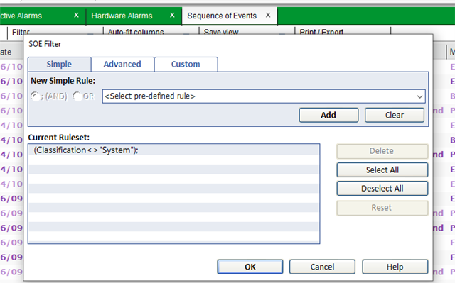

Unfortunate the system events are still present if I follow your example. No matter what filter I try they are still present. Unchecking Cluster do not help. Is there some INI file setting/Parameter that needs to be set as well?
