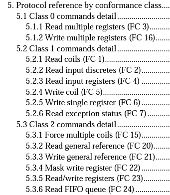

Normal integer writes use either Modbus Function Code 6: Write single register, or FC 16: Write multiple registers, depending on how many tags need to be written.
There are actually 3 classes of modbus function codes. Very simple modbus devices may only support class 0 commands (FC 3: read multiple registers, and FC16 write multiple registers). This is the minimum useful set of functions, for modbus devices. To limit communications to that leve in Citect, you have to set the INI parameter I mentioned to tell Citect to use FC 16 regardless of the number of registers it's writing.
Here's a clip from the Open Modbus/TCP Specification:
