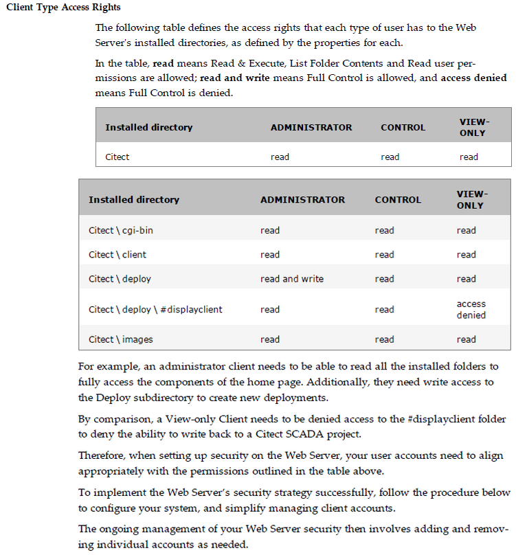

Yes. You need to use Windows Explorer to manually configure security settings to deny access to the Citect\Deploy\#displayclient folder under InetPub. Then, the view-only client users will only have the icon to run in view-only mode. Here's a clip from the "Installation Guide.pdf" on the Citect DVD where you can find the instructions:
Oh good point Eric Black , it is done in the initial setup, which controls whether control or view only is available per user. I do remember now that if done appropriately, the only icon the end user will see if the view only one. Thanks for sharing this!
Thank you for the reference Eric! You are right, it is in the install instructions. Much appreciated!
