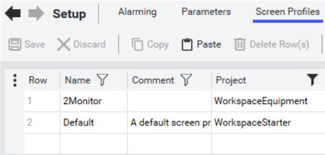

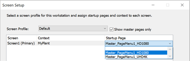

Hi all , I am new to the group and have just upgraded and old V7.2 to Scada2023 (Win11). Having issues getting the dua screen to populate correctly. I have set up the multimonitor however I cannot get the two screens to run full screen. When first booting runtime it is correct with both full screen but then it reverts to two smaller windows on the primary screen ???? Making changes to "Multimonitor" "Page" and "Animation" doesn't seem to have the desired results. Not sure if there is some other setting overriding these settings ??
in the citect.ini.
