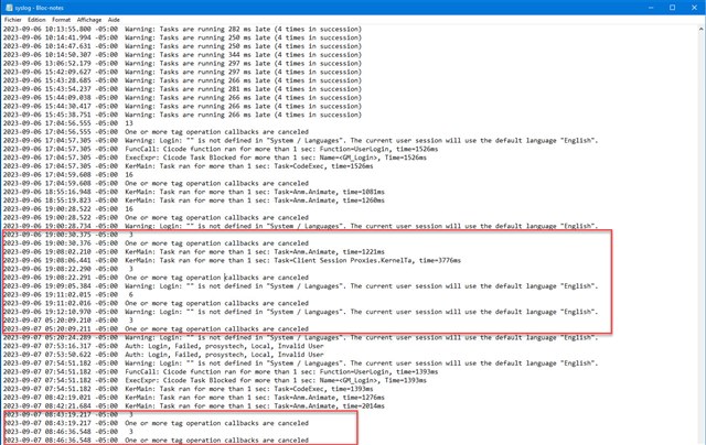

I've looked at the log files from the workstation and I've noticed the following errors ("One or more tag operation callbacks are cancelled") which occurred at about the same times that the commands were not working. There is also a "3" logged before each of these errors and also errors about tasks taking more than 1 second to execute.
Could these errors be the cause of my problem? I'm suspecting either a timeout issue or delays when the workstation is sending the command to the server (maybe the IT department added new firewall rules or something that is slowing the communication down? They have been having this problem for a few months but the system was running fine before (since 2006) and since 2016 with this version of Citect. This problem is happening on either one of their 5 workstations so it isn't tied to a particular computer.
