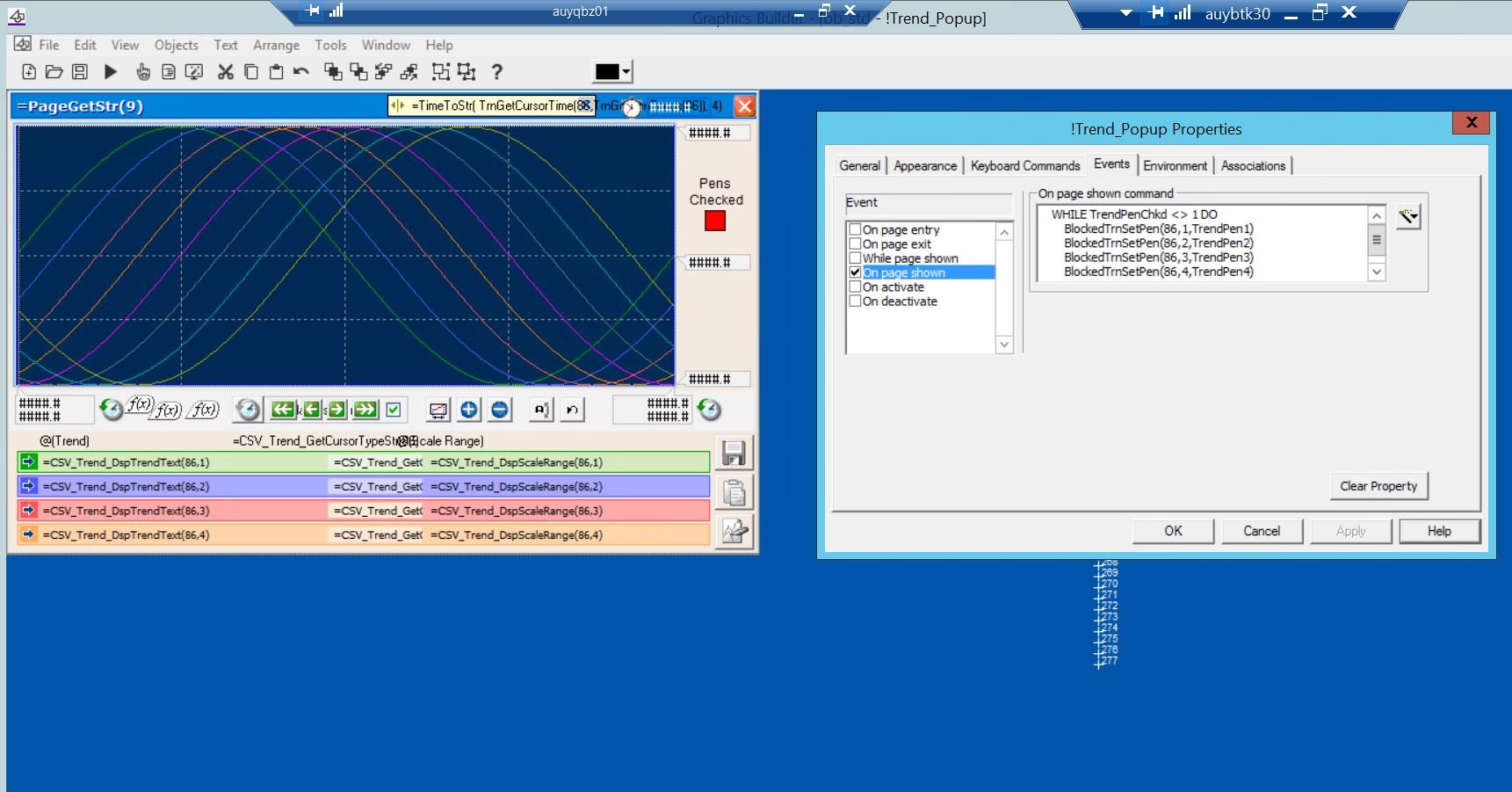

    Or, do you just have one Plant SCADA PC that is both a server and client? If that's the case, then as long as you are running in Multi-Process mode (selected in the Setup Wizard), you can just define an event that toggles your heartbeat bit. Then run the Setup Wizard and enable that event to run on the I/O Server process. The server processes by default have full privileges, even if no user is logged in to the client process.
    This screenshot is from the Power edition of Plant SCADA, but it's the same thing. Also, I like to name the event according to the PC or process where it should be run. You can have multiple events with the same name (it's really like a group name). It makes it a lot easier in the future when someone is running the wizard and may not be familiar with the events and what should run where.
