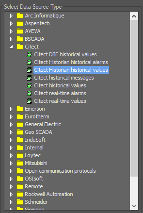

If you want to query with reporting in mind, the AVEVA Reports for Operation has native connector for Citect Historian. Both Alarms and Tags
This tool allows to set the report format to e.g. Excel format, if users just wants to play with the data. Otherwise the report can be configured to PDF and emailed to the clients.
Thanks. I see it now. I will try and check it out.
This worked great for me, I finally got it installed and tested. Thanks alot.
