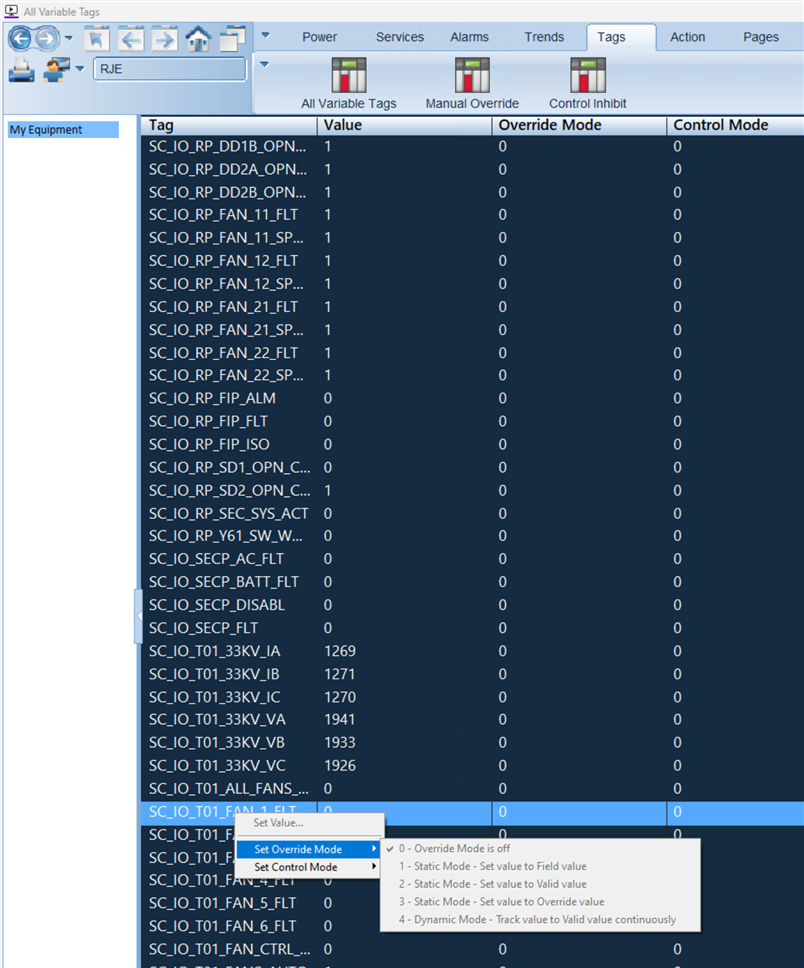

Hi All, Relatively new to Plant SCADA. I am trying to force/override values in Plant SCADA via the Tags-All Variable Tags screen below so I can test an OPC UA client reading those tags. The Set Override Mode fields are all greyed out. Is there somewhere to enable overrides in the system as a whole? Could this be a user permissions issue? I believe the user configured has the highest privileges.
Thanks
