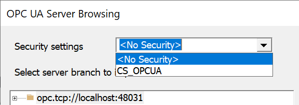

I have Citect Scada 2018 installed in a server with an OPCUA IO Device. It was working well but I had to reinstall all the server and the SCADA. Now I am facing a problem when I try to read the OPCUA device. When I see the IOServer Syslog I have the following message:
Error: Disconnected unit UINIT 000c PORT_OPC tcuopc Error_in_CMD-3 16 Generic 000012 Driver 00000023 (0x00000017)
I have installed the SCADA and OPCUA client driver. When I use the configurator to configure the OPCUA I can connect the server and with the Device Communication Wizard I can read the Tags. I have in the citect.ini the SecuritySettingsName configured with the configurator name. But when I open the SCADA all the tags apper as BAD or 0 and in the log appears the message I told before. From the same server I tried to connect with a comercial client and I can see all the values from the OPCUA server.
