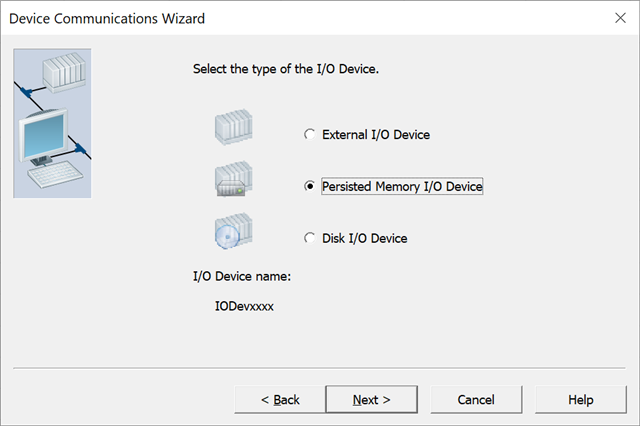

You should use persistent memory I/O Devices. These can be configured redundantly easily.
You can use any preferred protocol of yours to create redundant I/O devices in the memory mode. A quick way is to use I/O Device Wizard to create a device as Bas van Diepen suggested, as shown below.
Then you duplicate the new device and update it with another I/O server, startup mode and priority.
You can start adding variable tags after configuring these two devices. I suggest to use the OFSOPC protocol (driver installed by default) because Tag Names can be used as Addresses, which makes it easier to create variable tags.
