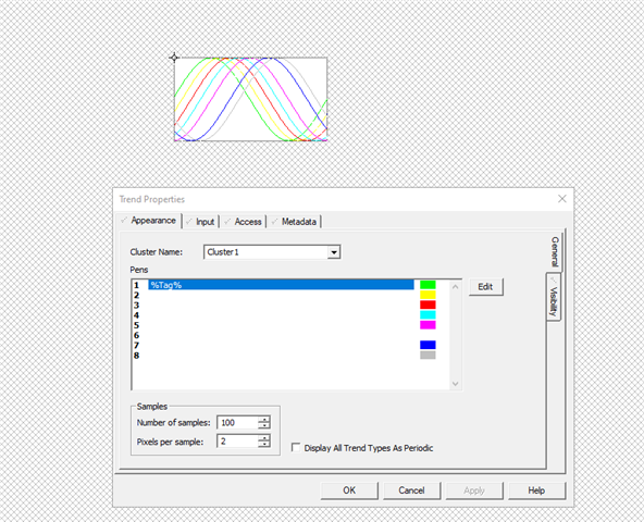

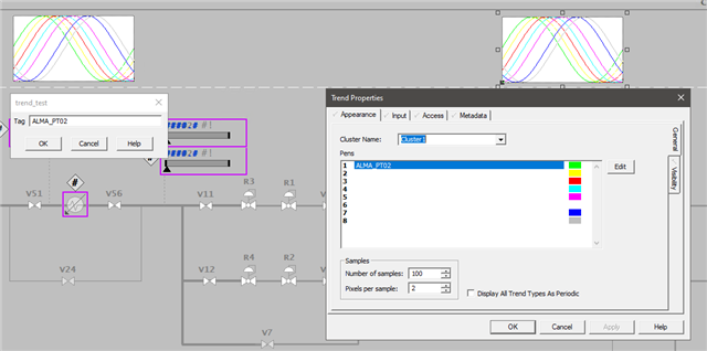

But now I notice that all my trend are displaying the pen line at the wrong place. I use the trend object inside a genie a paste this genie into a graphic page. I found that if I paste a trend object directly in the graphic page, everything work as it should, but the same trend but inside a genie does not display properly.
Here is photos of the configuration and the problem.
This is the genie with the trend object. Basically it's a trend on a white rectangle:
There's the genie on the graphic page and beside there's an trend object that is configure the same way:
This is the result in run time. You can clearly see that the left trend display the green line outside the rectangle and the right trend display the line correctly:
Anyone have an idea ? I have a lot of genie using similar configuration across the project and all of them seems offset now for a weird reason...
