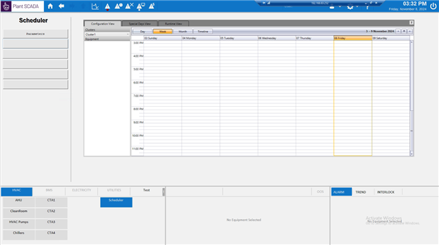

List of equipment not appearing on scheduler at runtime on aveva plant scada.
Equipment types created.
Added 2 states (ON & OFF).
Created an equipment with the equipment type.
The list of equipment remains blank at runtime.

Hi Persand Keshav ,
Could you please refer to https://docs.aveva.com/bundle/plant-scada/page/1148983.html?
Hope it would help.
Regards,
Jacky
In the equipment (model) properties, did you set Scheduled: TRUE?
