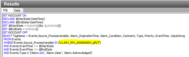

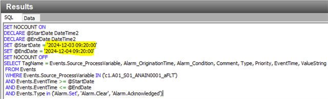

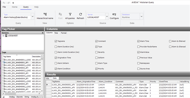

How is the alarm history is mapped to Historian events? How to view them? I'm using 2023 versions for both SCADA and Historian. Historize is set to true and I see the the values counter increment in the historian administrator for every alarm event(On, Off, Ack). However, I see no new 'event' tags when browsing with historian client tools(Trend, SQL). Does anyone know where I can get more info on this?
