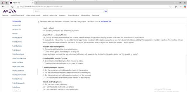

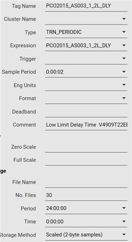

Observation is about Citect 2018. We have created Trend Tags with Sample Period of 2 Sec as below..

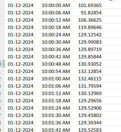

Trends are working fine. The observation we had now we export the trend sample in Runtime we found Sample as not for Every 2 secs what we have configured..

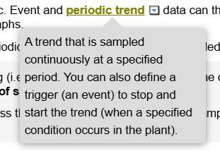

I check the help and found this is may be due to Trend Interpolations.
Please help me to understand
1. Trend interpolations
2. How it affecting the Sample periods to be taken every 6 seconds and overriding the defined sample period of 2 Second.
Apreciate your help.....
