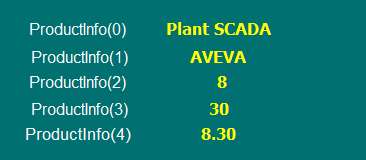

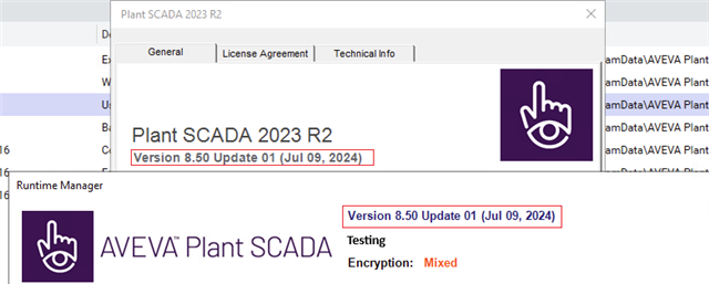

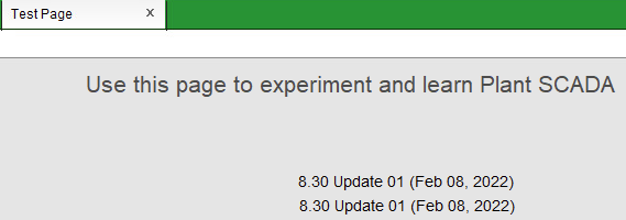

how do i find which update is installed for Plant SCADA 2020R2 in Studio
and
can this be displayed in Runtime ( i had code for this in Citect 2018 "below" which now does not work in 2020R2 )
