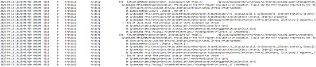

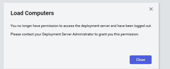

The user we setup when we installed works fine, but if I create some domain groups and add them into the deployment roles and add users to the domain groups, when I try to use one of these users to login to the deployment server, I get this error:
Additionally, no matter what I do to the group membership of the original, setup user, that one always seems to get access.
