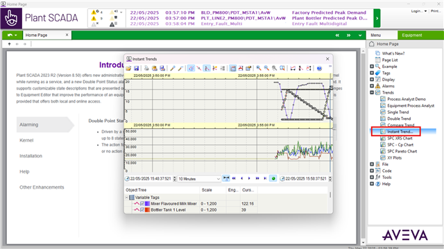

Try to use Example project as shown below. Take a look at how Instant Trend pops up and passes variable tags (instance trend) and trend tags (historical trend).
Yeah I've tried these and the PA pops up but doesn't have the pens added. For context I want to have a genie which you press to trend specific tags.
