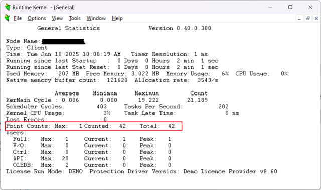

2.How can I see how many tags I used (necessary for the license) All the tags from Variables are used from license tags number?

EDIT: I hope will help somebody:
1. Variable Tags are variables that are actually connected to the I/O Device (including DISK I/O).
Local Variables are variables that are used only within the project. They will be cleared every time the runtime is restarted.
