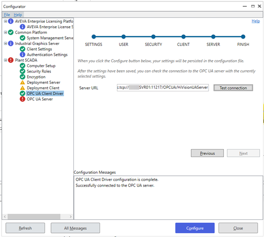

I am having issues connecting to OPC UA server on using PlantSCADA2023 OPCUA Client driver.

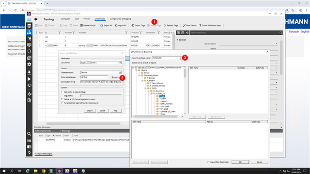

- Configurator setup is complete and test connection works

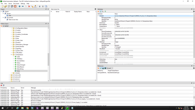

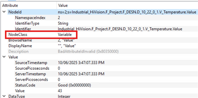

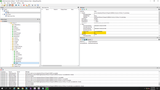

- i can browse the tags using UAExpert

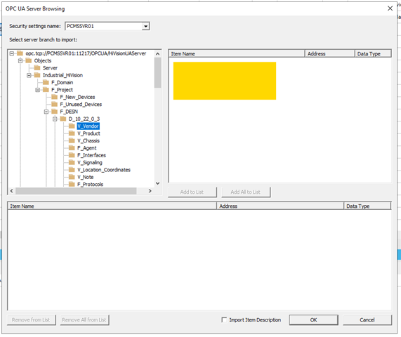

- I can view the folders, but not any tags using citect tag import function

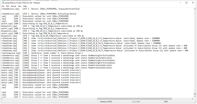

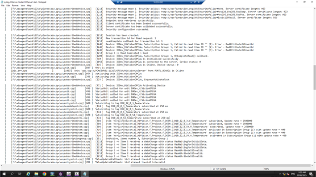

However when i run the SCADA applicaiton, I am getting the following errors:
Any idea with how to proceed?
