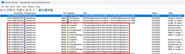

what i am noticing is slow performance in read/writes to this database file. Note the code is 7 + years and has not been modified so has proven very reliable to now.
i am trying to understand the data flow and where the issue is.

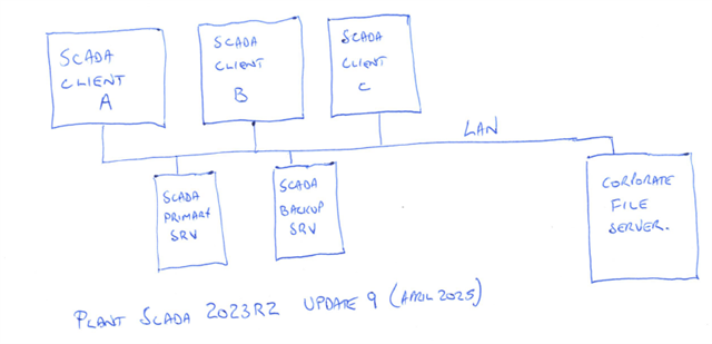

when operators make a change to the process, a cicode file writes this change or reads from the *.dbf file that resides on the "Corporate file Server" in a folder.
the folder and file is mapped as a network drive on the SCADA server. in devices "file name" field \\Servername\database_folder\MyDB.dbf (example only) is the path to the location on the corporate File server
for the above configuration i would like some explanation of the data flow for this.
QUESTION when an operator makes the change from either SCADA Client A, B or C is the data written to the corporate server directly or via the SCADA server?
- SCADA Client > Corporate Server
OR
- SCADA Client > SCADA Server > Corporate Server
