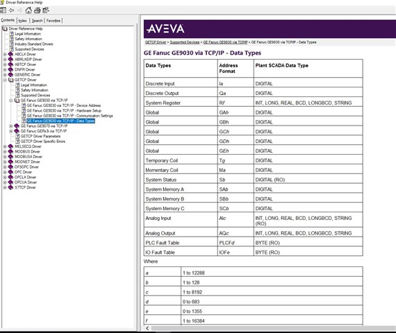

When I open the "Driver reference help" I can see the address format for reading various variable on the PLC(see attachedd image)
Since there is no mention of Symbolic addressing I doubt plant scada can read symbolic addresses from the GE plc. I have no means of testing this. In the meantime I just use the tagname /variable name  in the address colomn in plant scada . not sure if it will work.
