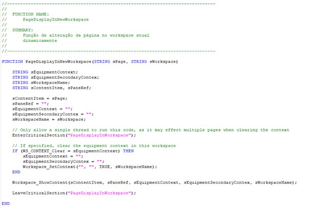

  • The function created is:
    The new masterpage is not called.

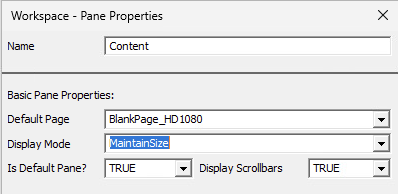

  • The best practice is to use a singleton of master page. In your case, you should change the properties of the display mode and scrollbars, as shown below. You could use "Stretch" mode and turn off "Display Scrollbars". With this configuration, the target page will fit in the content pane in the full size without scrollbars. Hope this would help.

    1. Is the page bigger or smaller than all the other pages? if so, you can use the content pane properties to add scrollbars if it is bigger, change stretch mode etc. See Jacky's answer.
