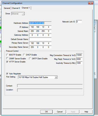

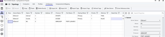

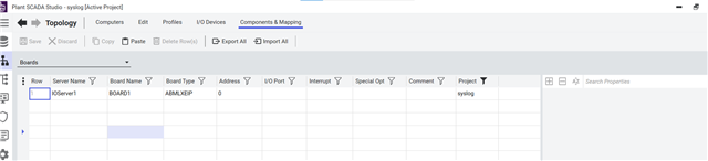

Dear Community, I have Allen bradley micrologix 1100 having IP Address 192.168.10.4 which is installed on VMware and I have Plant SCADA having 192.168.10.10 IP Address, which is installed on Windows 11. Both are on same network having same subnet. I want to communicate the PLC and SCADA I have added IO Device:
Allen Bradley>Microlgix.
and assigned proper PLC IP Address and Port number which 44818 for allen bradley. But I am unable to make communication between PLC and SCADA. Please guide me how I can establish a connection between both PLC and SCADA.

Dear Community, I have also attached the snap shots for the reference.
