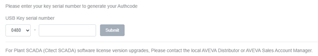

You can check and use the CiUSafe Key Update with the Authorisation Code from below link.
https://softwaresupport.aveva.com/LicenseGenerator/Citect/#?selectedTab=LicenseGenerator
Therefore, any new licenses, you can perhaps at to that or new keys.

Thank you Kien,
This is much appreciated.
Can you simply input the serial number and click submit?
